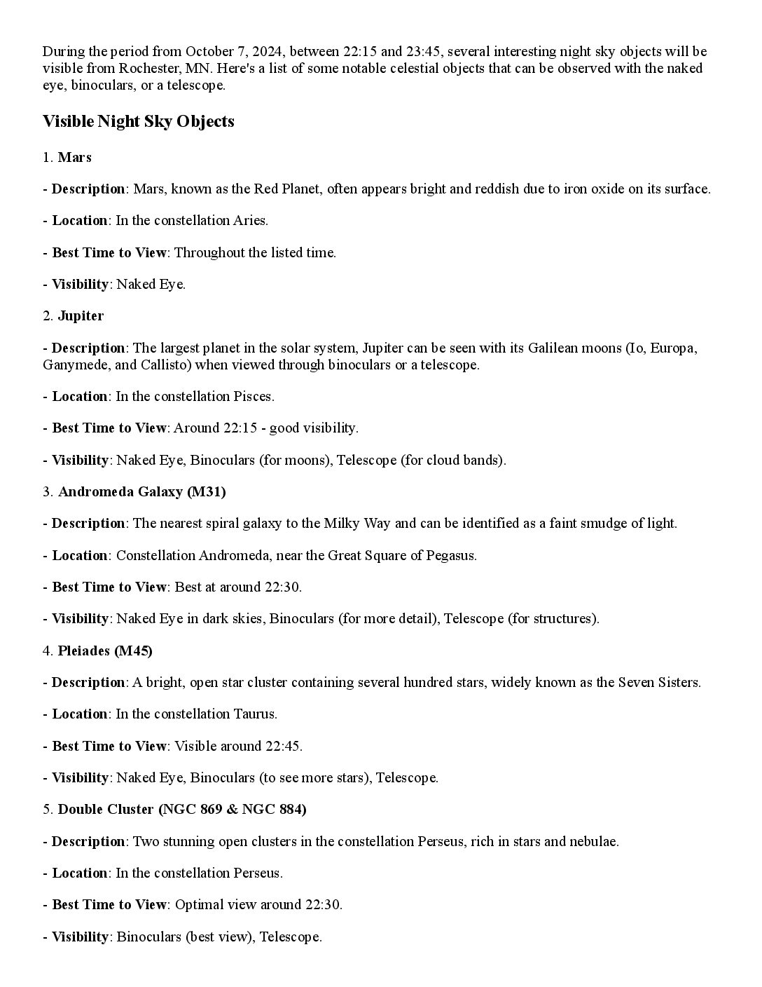

        I tried to generate for the period from October 7, 2024, between 22:15 and 23:45. See attached PDF.
        Here is what I found not accurate:
        #1 Cannot not be visible: Mars is rising around 23:45
        #6 Cannot not be visible: M8 is setting down around 22:15
        #7 Cannot not be visible: M42 is rising around midnight
        #9 Visible only short time, in different constellation: Ceres 8.97 mag is in constellation Sagittarius, not Virgo and sets at 22:44
        #10 Cannot not be visible: Copeland’s Septet is in Leo, not Pegasus and those galaxies are challenging to observe
