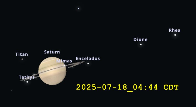

Saturn, Titan and other moons at time of the mid of Titan shadow transit 2025-07-18 according to Stellarium.

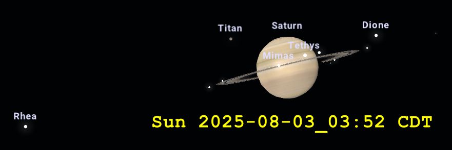

Saturn, Titan and other moons at time of the mid of Titan shadow transit 2025-08-03 according to Stellarium.

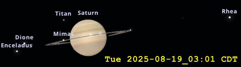

Saturn, Titan and other moons at time of the mid of Titan shadow transit 2025-08-19 according to Stellarium.
